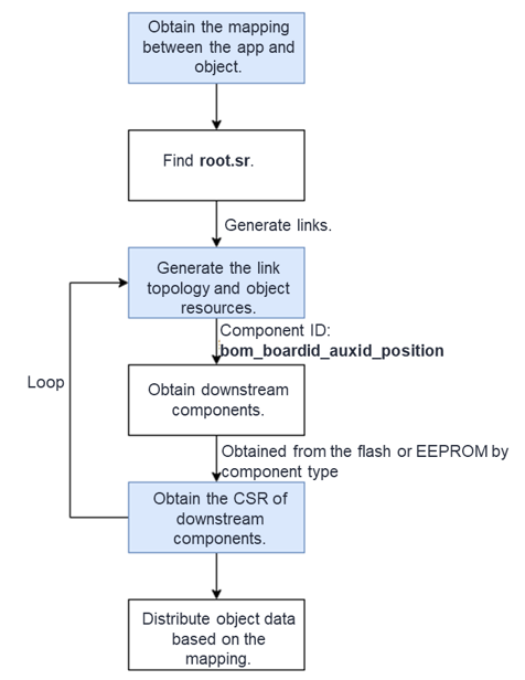

Hardware Component Discover Process
openUBMC discovers hardware components based on the toplogy of the server. In a typical Tianchi server design, BMC card is connected to the EXU(Extension Unit), which also connects the BCU(Basic Computing Unit), CLU(Cooling Unit), SEU(Storage Expansion Unit) and PSU(Power Supply Unit). IEU(IO Extension Unit) is connected to the BCU and PCIe Cards are connected to the IEU. openUBMC follows breath-first search algorithm to discover the hardware components level by level via Connector. For details about the hardware discovery process, please refer to Hardware Self-Discovery for more details.
Due to the discovery process, CSR are conncted by Connector. Therefore, Connector contains the association information between CSRs. For details, please refer to Connector Object.

  2. Figure 1 shows that root.csr -> EXU. You can view the Connector information of root.csr to find the CSR file of the EXU board.

    Explanation:
    a. According to the preceding resource collaboration interface information, the Connector object that connects to the downstream board 14100513_EXU_01.csr in root.csr is Connector_EXU_1. For details, see bmc.kepler.Object.Properties.
    b. The attributes and attribute values of Connector_EXU_1 are mounted to the bmc.kepler.Connector interface. You can query the value of IdentifyMode to determine whether to use the Tianchi or non-Tianchi component to load the downstream component.
    c. IdentifyMode = 2 indicates the non-Tianchi loading mode. Combine the Bom, Id, and AuxId to search for the downstream component Bom_Id_AuxId.csr.
    d. IdentifyMode = 3 indicates the Tianchi loading mode. Combine the Bom and Id to search for the downstream component Bom_Id.csr.

Loading Modes
IdentifyMode is used to define whether the downstream component is Tianchi or not. If set to 3, openUBMC will load the CSR from Eeprom following the Tianchi discovery process. If set to 2, then it will load from local CSR.
root.sr -> EXU -> BCU/SEU/CLU/PSR -> IEU (I/O expansion component) -> PCIe
Loading Mode of Tianchi Components
Take the BCU Connector on the EXU as an example (as shown in Figure 1). If the Presence attribute of Connector_BCU is 1, that is, the connected BCU is present. In this case, the framework automatically reads the register (EEPROM) of the downstream object, parses and verifies the UID (unique identifier of each Tianchi component) in the header data in the EEPROM, updates Connector ID, parses the binary data of the EEPROM, and distributes the downstream object. The framework obtains the Bom_Id.sr of the downstream object based on the Bom attribute of the Connector and the UID in the parsed EEPROM data, and directly loads the downstream object file in the EEPROM.
Loading Mode of Non-Tianchi Components
Take the PCIe Connector of the Riser card as an example (as shown in Figure 1). During initialization, the PCIe Device component sends an ipmi command to the BIOS to obtain the 4-tuple of the PCIe card in in-band mode and update Connector id and AuxId. Similarly, if the value of the Presence attribute is 1, the downstream component object of the connector is present. In this case, the framework checks whether the Bom_Id_AuxId.sr and Bom_Id_AuxId_soft.sr object files exist and directly loads the built-in .sr file of the BMC.
